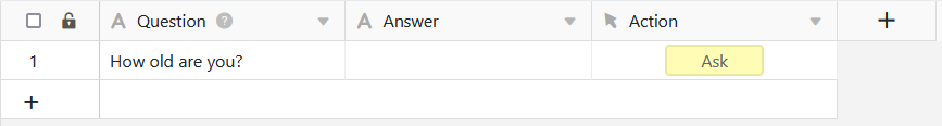

So basically, this should do the trick. But you have to add the bearer token you got from ChatGPT and put it into the variable bearer in the script. I do not have a paid account, so I cannot test the output to write a fully functioning script. Additionally, the script (JavaScript and not Python) acts a bit different since you do not get a dialog to select a text. You just have to click on the button in the specific row.
Here is the script. If you create the columns with the exact names, it should work.
