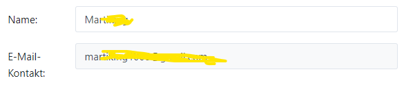

username is Name ?
Username should be the email address you use to login. I have tested it myself just now and it worked. Maybe check your email and password again?
i just tested it but on seatable.com i log in and it works but on the api side not.

Can you show me where i can find my username and send me a example?
Omg i stupid username is the mail.
but now the created token dont work on ping
