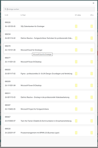

Ein größeres Problem bereitet uns, insbesondere auf Dashboard-App-Seiten folgender Umstand:
Wir haben Dashboard-Seiten eingerichtet, um z.B. ToDos prozessabhängig zu überwachen und zu steuern. Sehr wichtig ist, die in der Überwachung auffällig gewordenen Elemente über den Drill-Down zu erreichen.
(a) blockiert uns hier das Limit von nur 10 angezeigten Treffern in der jeweiligen Ergebnisliste. Weder gelangt man hier über Weiterscrollen, noch über Paginierung, noch über eine Suche an die weiteren Treffer.
Ist das evtl. ein Bug? Gibt es eine Lösungsmöglichkeit?

Regarding (a): I can’t reproduce this behavior in any of my apps. Nowhere do additional results load for the 10 hits displayed in the drill-down search when I scroll down. The fact that we can’t get more than 10 hits is really problematic for us. I’d be very grateful to receive a working (temporary) solution here.

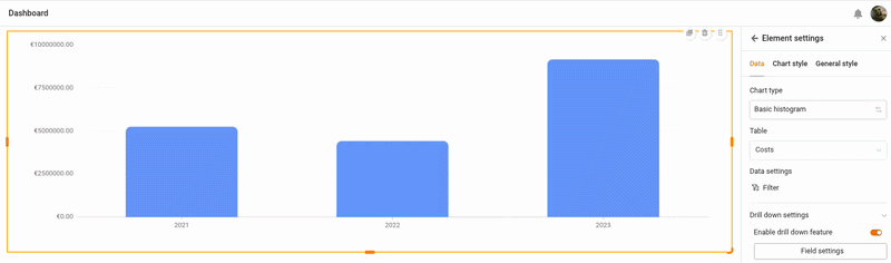

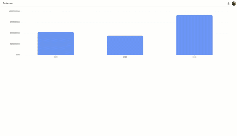

a.) There is a container element for exactly this purpose.
b.) You can adjust the size of elements manually.
ezgif.com-video-to-gif-converter (1)
For feature requests, please use https://ideas.seatable.com.

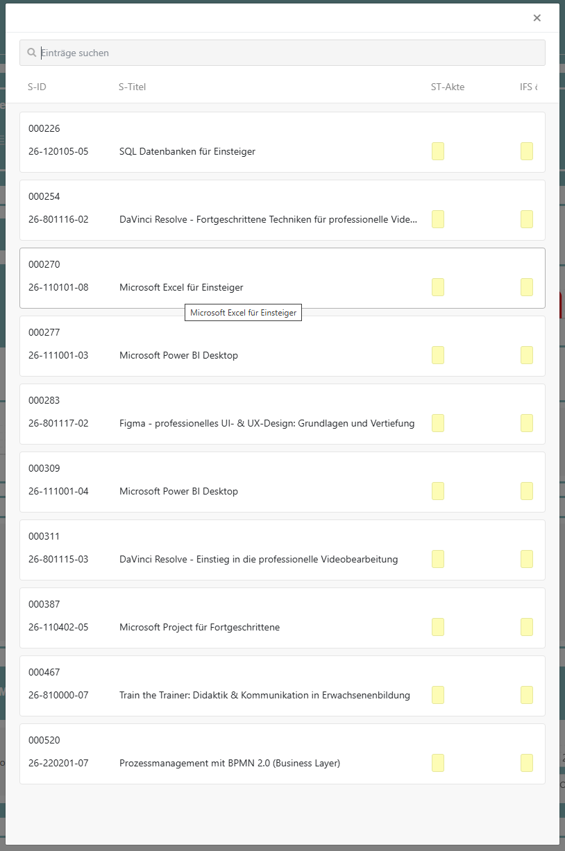

Cache is empty now, as you see, i don’t have a scrollbar to get more results. In this case there are 16. I am using Chrome, the browser you recommend.
Sorry, the first asset in my prior post was an image, though it was supposed to be an animated gif. Please check my previous post again.
I just realize an important difference between my demo and your screenshot. In my demo, the scrollbar is already displayed when I open the drill-down dialog. In your screenshot, there is no scrollbar.
Consequence: Try reducing the height of your window.

Hi,
Thank you for pointing this out; this has helped us pinpoint the problem:
The responsiveness of the Seatable app is apparently limited.
The vertical scrollbar does not appear at every screen resolution. It works on a laptop screen (1920x1080), but we’re working on monitors with a resolution of 2550x1440, and the scrollbar doesn’t appear there—only when you minimize the window.
Is there an estimate for when this bug will be fixed?
Thank you for the detailed feedback and for helping us pin down the issue!
We have forwarded this bug to our me/development team. Currently, we don’t have a specific timeline for when a fix will be released. We will keep you updated as soon as there is any progress.
