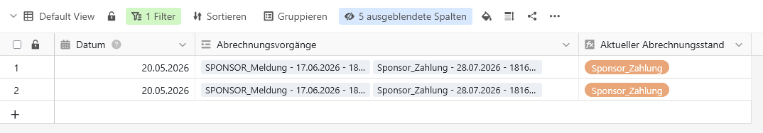

This is the table:
This is the filter leading to a 500 error
This is the filter that leads to empty rows being returned
This is a filter that works fine because it points to the first entries in the link column and not the second

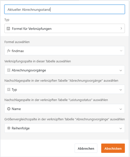

These are the settings of the link to other table column “Abrechnungsvorgänge” (the column name of that table is of type function and concatenates multiple strings)
These are the settings of the column “Aktueller Abrechnungsstand”

This is the table Leistungsstatus:
This is the table Abrechnungsvorgänge:
“Name” is just a concatenation formula. “Positionen” is a link to the Table where the bug occured.
This is the table “Abrechnungspositionen” where the error occurred

I noticed the warning triangle, when filtering for strings in a link column. I just wanted to share with you my experiments while studying this bug. And for some reason filtering for a string that is part of the second link leads to an empty array of rows being returned, while filtering for a string that is part of the first link doesn’t. Its just what I noticed.
