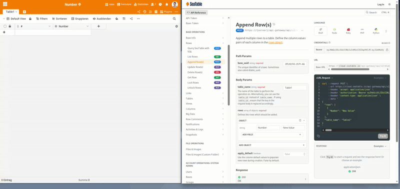

Bildschirmaufzeichnungvom2025-11-2617-16-32-ezgif.com-video-to-gif-converter
Thank you for the video.
It confirms that a numeric-looking value arrives in the table — but unfortunately, from the video alone it is not possible to determine whether SeaTable Cloud is storing it as a real number or as a string.

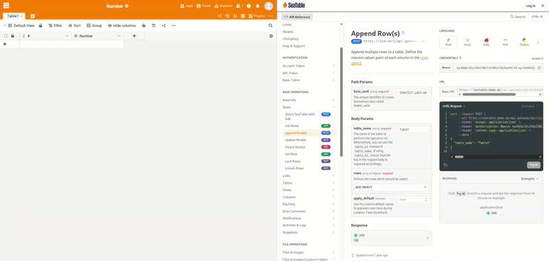

In the video below, I first add a row and write an (integer) value into a number column and then I update the value in the just added column:
Bildschirmaufzeichnungvom2025-11-2715-04-54-ezgif.com-video-to-gif-converter
Numbers are processed as numbers: they are right-aligned, they are summed - both demonstrated in the video. Though I must admit, after writing the initial value, I had to refresh the page once for SeaTable to calculate the column sum.
Could you simply redo the exercise I have done yourself? You’ll come to the same conclusion.
