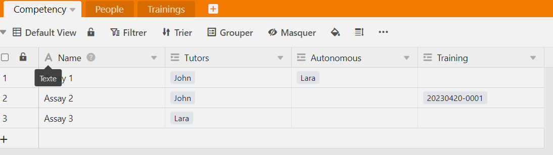

I made a list of interacting links :
Request.Trainee name ↔ People.Request
Request.training-request ↔ Tests.Request
Request.Tutor chosen ↔ People.Tutor selected
Trainings.Trainee name ↔ People.Trainings asked
Trainings.Tutor chosen ↔ People.Trainings made
Trainings.training-request ↔ Tests.Trainings
and
Request.Tutor potential is a lookup formula from training-request with the Tests.Experts column
