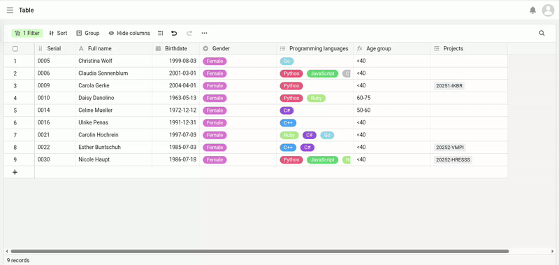

But I continue to fail to reproduce your problem description:
Bildschirmaufzeichnungvom2026-02-0922-40-28-ezgif.com-video-to-gif-converter
Could you elaborate on the issue?

I was able to see the video but I can’t reproduce your issue: when I click the + button on the bottom-left corner of a group to create a new row, it actually directly creates a new row without opening the edit modal as it is the case in your video. Is this behaviour (directly opening a modal window) specific to Arc browser? Did/Do you have the opportunity to test this on another browser?
However, please note that in my case, setting the default value for the filtered link-type column works only if I define the filter directly in the view (in the top toolbar) and not in the app settings (right panel). For the group, I get the default value wherever I set the grouping rule.

I was able to watch the video, and maybe this helps to find a possible misunderstanding:
@fpiovesan the filter you are setting is NOT a display filter, but a “preset filter“. Which means that the data is never pulled from the server for this view (a very important feature of Apps in terms of data protection and performance). Therefore, a different logic applies.
Basically, how should the add action populate the column, when the relevant data to populate it with is not in the App?
