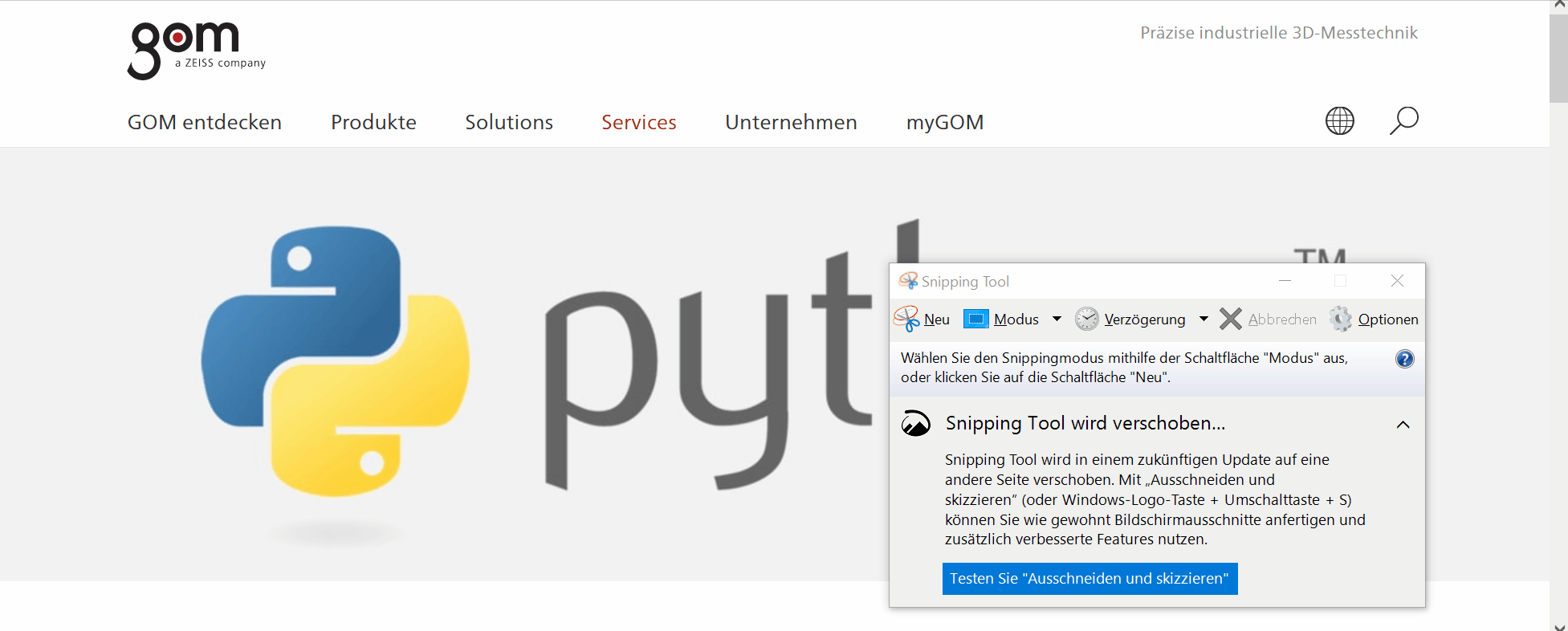

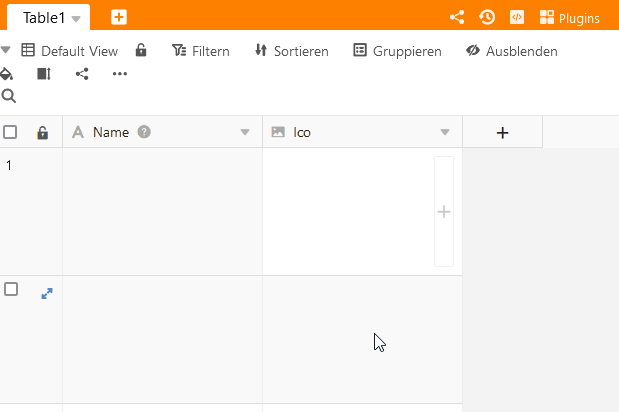

I have visualized the process of pasting from the clipboard for better understanding. To do this, I created a new test base, and created an image column there. The row height is set to “fourfold”. Then I took a screenshot of a square Python icon (clipboard). It doesn’t matter with which app the screenshot is made.

Clipboard
I did what you did and - what can I say - it works:
ScalingImages
