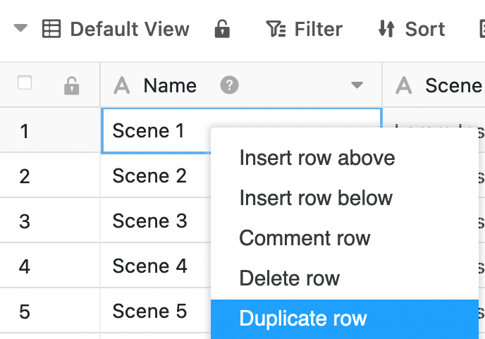

Using the context menu:
The duplicate row bug is still existing in 2.0. I will try to illustrate the issue in more detail:

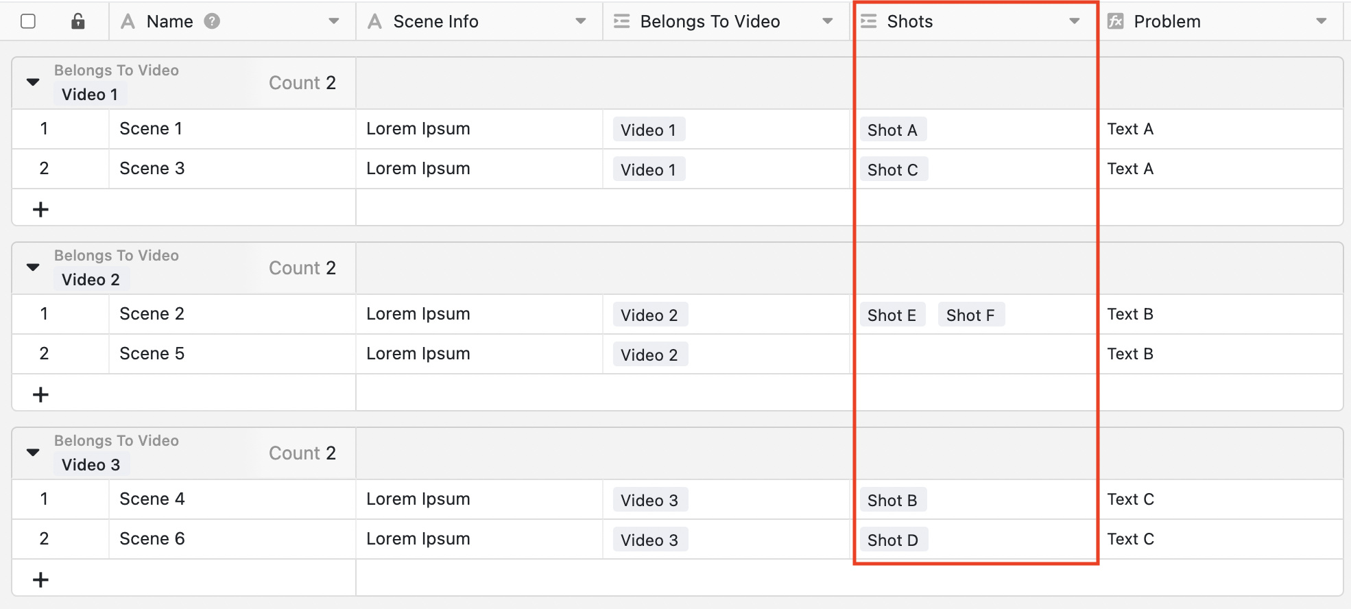

We are looking at the ‘Shots’ column of this table.
I’m duplicating the row with ‘Scene 3’ using the duplicate row context menu.
Then I add a new link to the duplicated row.
The previously added link also gets added to the original row. To reproduce you have to click the original row once (otherwise it’s not initially visible). Those two rows stay connected this way (every change you make in one also affects the other) until you delete all the contents from one and re-populate from scratch.
As mentioned before, in at least one case (grouped and filtered records combination I cannot remember) this behavior led to complete mixed and messed up records through the whole table (also rows that haven’t even been touched).
I finally could understand what this issue is, and have just reproduced it. Thanks for letting us know.
