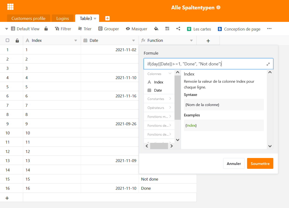

According to the formula reference, the IF function only knows 3 parameters: Logical, value 1, value 2. You use four which cannot work.
Based on your explanation in the text, this is what I build:
There are certainly other ways to achieve the same result.
Just write if({date}, "Done", "Not Done") . A value is automatically considered false if it’s empty.
