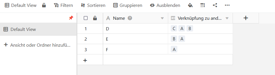

I’ve been commenting another post here and had the thought this might be the solution to your problem. If you create a new view on the linked table where all the dates are stored, and sort it to have youngest date at the first place, the cell in the main table will sort all related entries the correct way.
Like…
Have a look at https://forum2.seatable.io/t/per-view-form-column-sorting/1784/2?u=akdk7.
Am I right?
Thank you very much for your suggestion! It seems this has solved the second part of my question, namely how to sort the suggested records with the latest first.
This is extremely useful. :smile: Now I am wondering if there’s a way to see the related records in the cell with the latest first… like C, B, A in your example screenshot (I am seeing C, A, B on your screenshot).

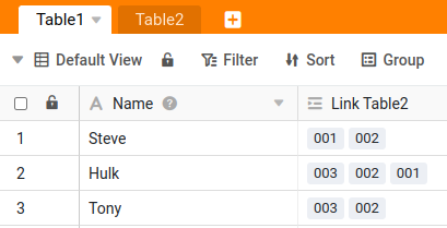

Linked records are ordered by sequence
I can confirm that entries in the linked column are ordered by the sequence they are linked.
That means, no matter how you sort Table2 the sequence of “003”, “002” and “001” will not change.
In the case of “Hulk”: “003” was added first, then “002” and finally “001”.
Currently, there is no way to change this sort.
Use “Findmax” to get the latest or earliest date
a possible solution would be to use lookup “findmax” to get the latest dates from the linked records. Here is the example:
This is Table2:
This is Table1 with findmax column:
This is how the findmax is configured:
This is probably a solution to your requirement.
