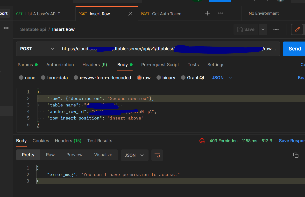

I’m triying to insert a row, with the api but it say “You don’t have permission to access”,
I have generated my token and it give status 200 y then I use that token to run the endpoint
https://cloud.seatable.io/dtable-server/api/v1/dtables/:base_uuid/rows/
but It say “You don’t have permission to access.”

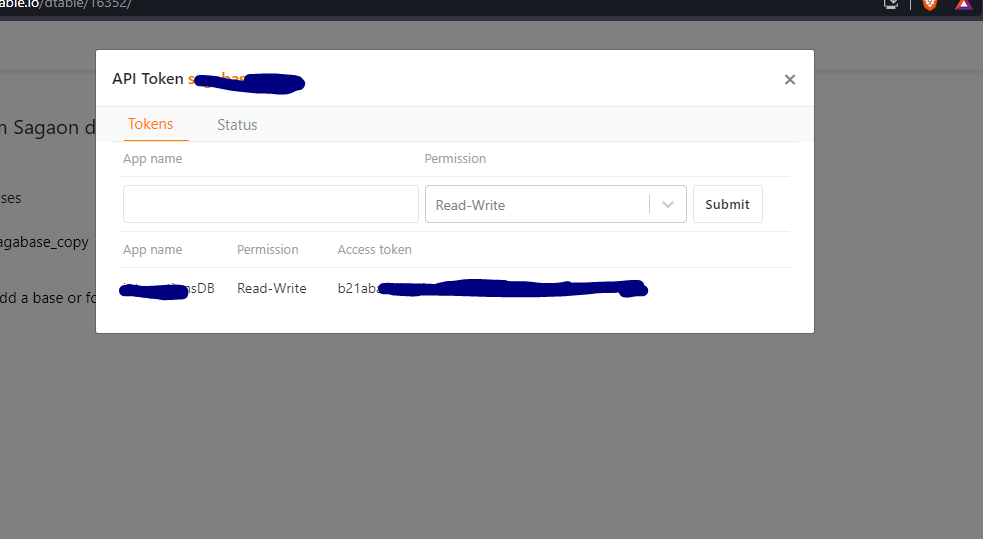

Maybe your token has only read-only permission?

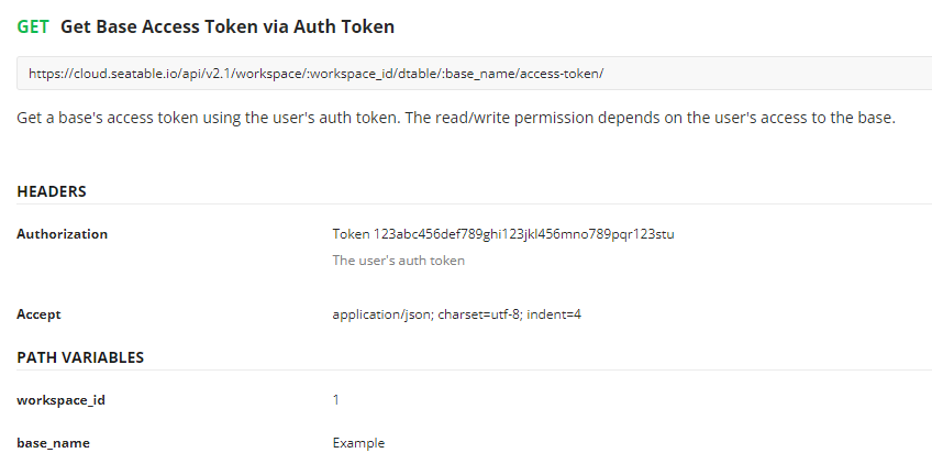

Exactly which token are you using? As I see “Get Auth Token” on your screenshot. The Auth Token doesn’t work for this call. For this call you need the Access Token.
I see. Although it says “access token” on this dialogue, it’s not the access token you need for this API request.
What you need is this one:
