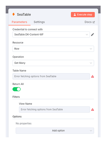

Issues: * There was a problem loading the parameter options from server: “The resource you are requesting could not be found”

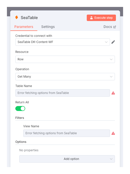

  1. I use the cloud.seatable.io version ( more specifically Log in - SeaTable Cloud in case you can see it ).
  2. n8n is self hosted and on the current version 1.100.1 now.
  3. I see also in the logs “404 - “This endpoint is deprecated. Please migrate to the API Gateway: …””

I see the problem now, the blueprint has this n8n version: image: docker.n8n.io/n8nio/n8n:1.83.2 That’s a bit outdated. The current stable version is 1.100.1 can You upgrade n8n to that version?
Or just use :latest which contains the latest stable version.
Another option is to use the n8n seatable community node instead but upgrading n8n is highly recommended.
Was planing to write a self hosted howto on how to set up n8n including backups, I should really get to that.
Following worked for me.
  1. Update latest Version
  2. Create new Seatable Node
The old node had the issue to succesfully connect but does not fetch
New node runs like without a flaw
Recreating the nodes helped.

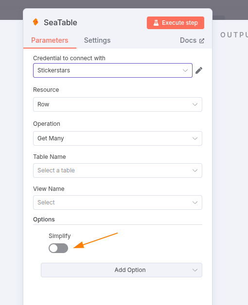

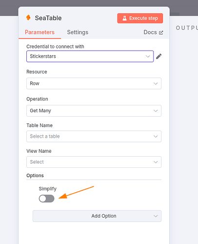

Only since the new nodes are used the “Get Many [Rows]” does not deliver the Seatable Row-id anymore. :-/
Set the option Simplify to false, then you also receive the _id of the row.
