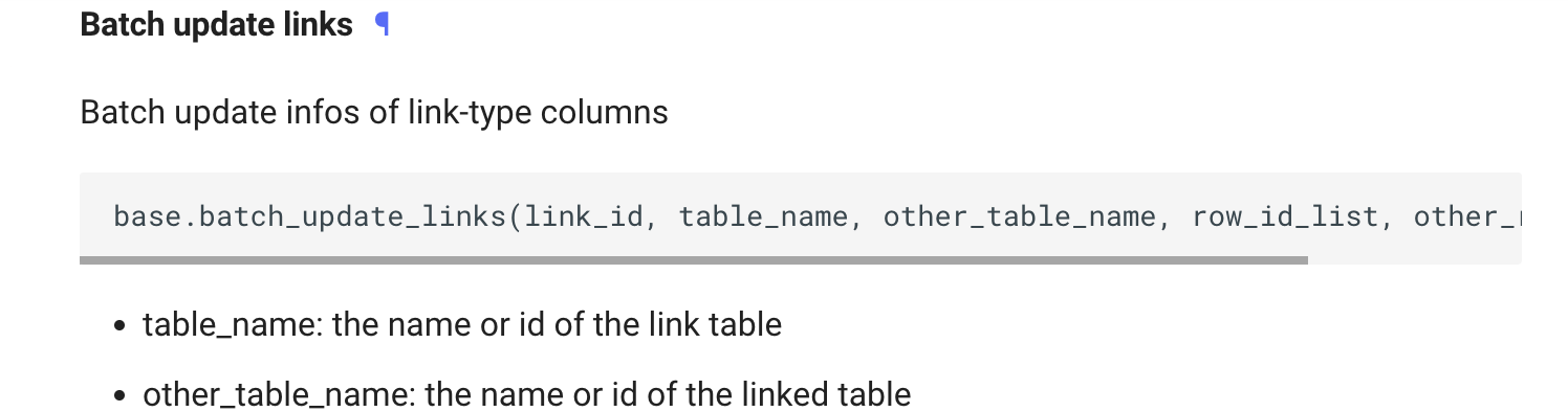

What I just realized is why is it changed to table_name since it’s the id of the table. Is it now possible to put the real name of the table, which the user can define in the gui, in it?
The document changed all id to name as I checked:
Yes, you can now use the table name the user defined in the web UI.
