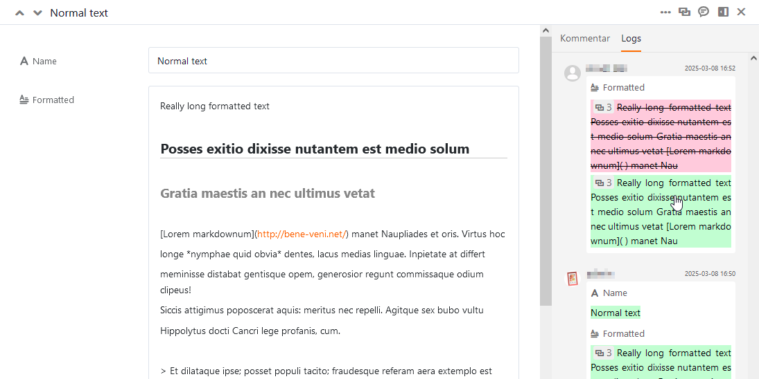

Hi, sure!
 ![grafik](https://forum.seatable.io/uploads/default/original/2X/a/a11b31f672ee306d9b2a725f2d504546f7982f7f.png)
clicking on the log entry for the change of the formatted text shows this
 ![grafik](https://forum.seatable.io/uploads/default/original/2X/4/44ce13d10254aaddd4fe73cc7cab7fff4a8c7f17.png)
no chance to reach the part of the text that was actually editied.
However, I just had a suspicion: Is it possible that the change log only saves part of the formatted text? In this case, a scroll bar wouldn’t make sense, because there would be no more text to scroll to.
In the case where people started to notice, the text was extremely long, consisting of very short lines (lists, basically). That’s why users thought they could scroll if they hat a scrollbar.
Is it true that in fact, the text is just truncated?
