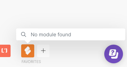

At the moment I still get the following message when I try to install via the invitation link:
No modules have been created in the app yet or they have a private status so you cannot add the app to the scenario. Please contact the author of the app or the administrator.

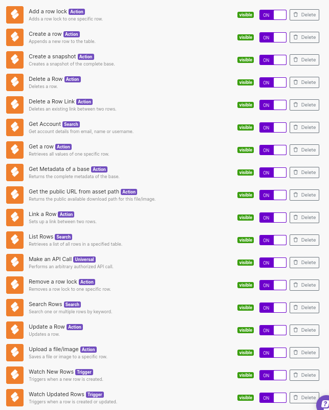

Hey Andreas,
Please give it another try. It appears that after “publishing” the app, I needed to make all the modules visible. You should now be able to see these modules:
Happy testing.

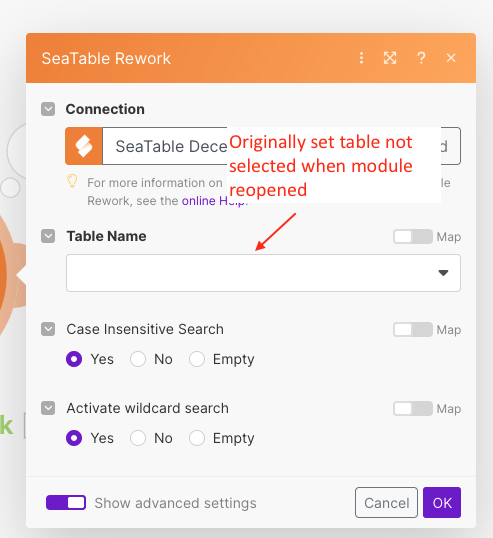

So far, the search rows module works fine but with one unusual thing. Once I set a module and then re-open it to change some settings, the originally selected table needs to be re-selected.
See screenshots
thanks for this hint. I found already the reason for that and I am evaluation how to solve this efficiently.

I could resolve the issue: Possible to return an object with an RPC instead of an string? - Custom Apps - Make Community.

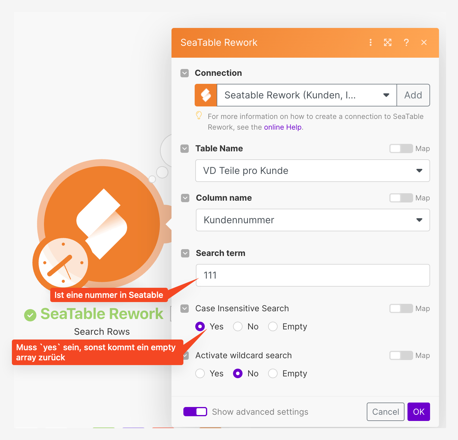

I have to activate Case insensitive Search, when searching through a row that contains number, or it’ll return an empty array.
So it technically works, but is an unexpected behavior.

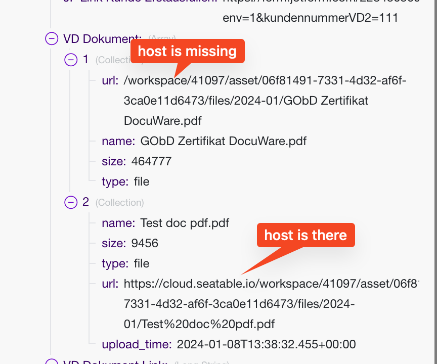

1. When a file is uploaded using the upload module. It is then missing the host name (example: https://cloud.seatable.io) in the database. This can be seen when with the get a row module.
The first bundle was uploaded with the make module. The second bundle was upload directly to seatable from my hard drive.
This could lead to trouble, because I would now have to check each url for the hostname, before I can get the download URL through the get the public URL module.
Please add the hostname to Uploaded files from make. :slight_smile:

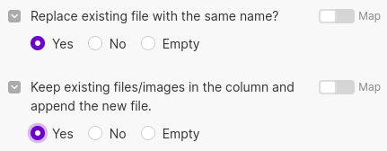

2 The upload module in make takes all associated files out of that row and replaces them with the uploaded file.
In the upload module, I can tell seatable to overwrite a file if the names are the same. But this does not seem to work properly.
If the names match, the file would be overwritten if the setting is true. If the setting is set to false, a copy is created instead.
At the moment, uploading any file to seatable, just disassociates all the other files from the row. Independent of the Replace setting used. They are still in the base, but not in the row anymore.

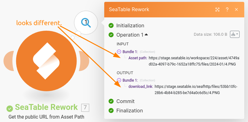

3. The get public URL module needs a way to set the file name. The returned file name for the PDF uploaded was utf-8. First this was not the original name and more importantly it was missing the .pdf ending.
It is not a breaking bug because I can just change the name later on. But being able to set the file name in the module would be cool.

  1. Search for a number: I checked, if it is possible to make it possible to search for numbers without activating “Case Insensitive Search”. This would require that make could detect what kind of input was provided. Unfortunately, this only works with a custom IML function, which I would like to avoid. Therefore I added a hint to prevent this situation.

I fixed this by adding another parameter:
I don’t get your point. My module “Get the public URL from Asset Path” module looks totally different:

Thanks! Keeping the files is working for files uploaded through make. If I add a file to the row in seatable, it will be dissaccociated. :frowning_face: :
