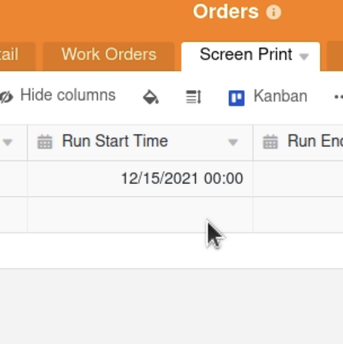

Thanks for your response Attached is screen shot!
As you can see in the date column type the time is shown as 00:00 instead of the current time referenced from calling new Date ();
And in the script I know it is referencing a different column name then what is in a screen shot I just am on the move and asked an employee to screen grab a column. We have 4 identical scripts dropping into for columns ā€œStart setup time, end Setup time, start run time, end run timeā€. So functionality is the same.
Thanks for your effort and the screenshot. Now I understand.
I think your script is missing something: the new Date() will return a datetime with minutes bu it cannot be written correctly into a date cell yet. You need the base.utils.formatDateWithMinutes:
let date = new Date();
let formatDate = base.utils.formatDateWithMinutes(date);
And then use the formatDate to write into your date column. Try if this helps?
