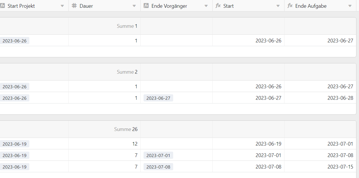

Hello I am trying to setup a project plan with seatable. Therefore I have to calculate dates out of a duration and a starting date of the first task in the project. This works now in the base. Now I want to add a timeline to the base. But unfortunately the dates calcualted and shown in the base do not occur in the timeline? I have read already the request timeline plugin cant select formula which should be solved since a while. For me my problem seems very equal but it is not working. I am using Seatable Cloud free.
Here a screenshot from the base

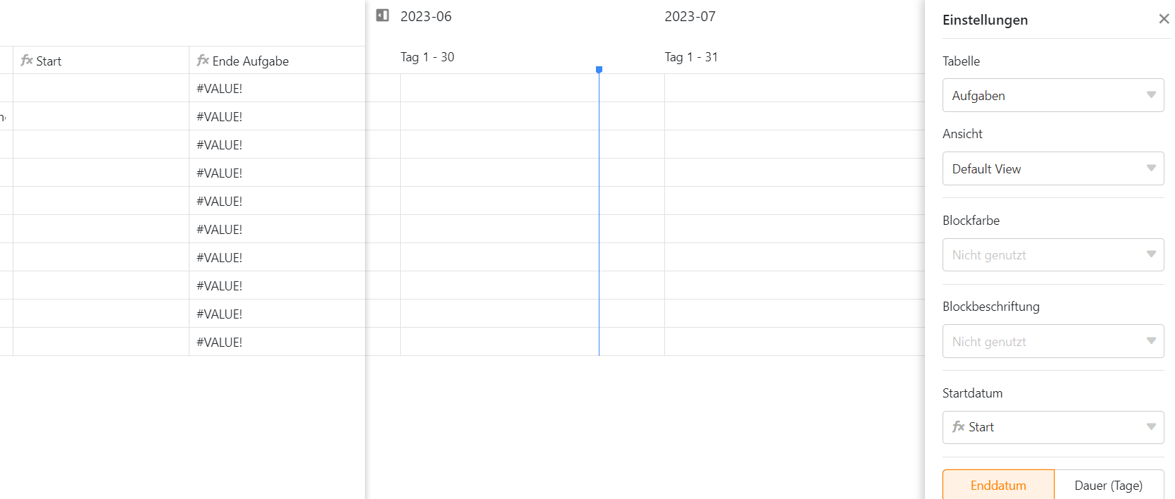

Here a screenshot from the timeline

The timeline plugin does not support all date formats yet. However, the ISO format was supported in my test, namely in the column type “Formula” and “Link formular”. The same way you used it.
Could you please send another screenshot of your timeline plugin settings?

Hey Felix,
here are two screenshots of the settings
I have checked, in my base the date is in ISO format as well.

Could you please show me another screenshot of the formula column where you calculate the date?
About the settings in the Timeline-Plugin: are you using the right table and view?
I am surprised that the error value #VALUE! is displayed.

Hello I created a link to share the complete base (SeaTable Cloud). As I am not sure what you are searching directly. I am trying to create a project management. So I have a start date of a project and tasks. In the tasks i get the starting date from the project. Each atsk has a duration and maybe a predecessor. If a predecessor exist I take the end date from it as the new start date and calcualte the end date with the duration. If there is no predecessor the start date from the project is taken. Finally I want to display the start and end dates in the timeline.
Maybe I am thinking to complicated. The columns startdate and enddate (manually entered) are only for checking.

Hi,
Start: if(isempty(“Vorgänger”),{Start Projekt},{Ende Vorgänger})
Ende: if(isempty(“Vorgänger”),{Start Projekt}+{Dauer},{Ende Aufgabe})
Ende Aufgabe: {Start}+{Dauer}
At the end of the day “Ende” and “Ende Aufgabe” is the same value so I need only one of them and hide Ende but now showed it again

Hi Florian,
After further tests, I came to the conclusion that your requirements are unfortunately not possible with the current SeaTable version and the timeline plugin.
I am sorry not to be able to give you a better feedback.
