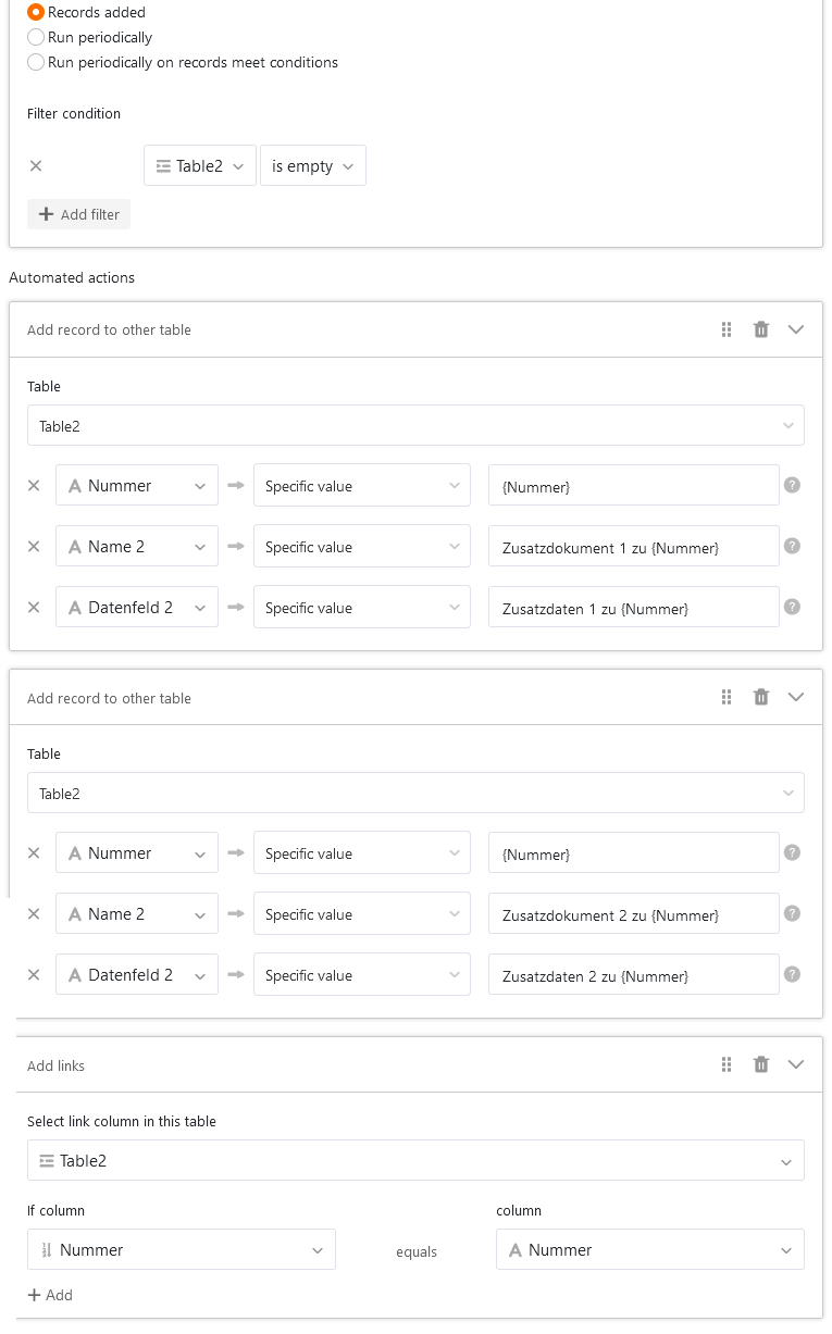

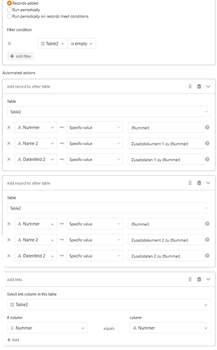

Version 5.3: I was not aware of any such timing conflicts. To challenge my ignorance, I ran a quick test in our test system (a plain vanilla SeaTable Server Enterprise Edition 5.3.12). The automation rule’s task: Copy a autonumber and a calculated date in two text columns when a new record is added. The result in the screenshot below:
Version 6.0: Identical to 5.3

@rdb the fact that auto numbers are availiable (=filled / generated) to subsequent steps does not only point to the hypothesis that mainly formula results (like rowid()) are not immerdiately calculated during or even before the “when a new record is created“ trigger.
I also found a solution to my current problem, using an auto number to link between records with a unique ID. I hope that helps others:
Only dodgy hack: The current automation editor seems quite picky copying values between columns of different types using the “column value“ option, so I used the old “specific value“ option along with the {column name} notation to transfer the linking value from “Table1/auto number column” to “Table2/Text column”. I hope the {column name} reference stays in 6.0.

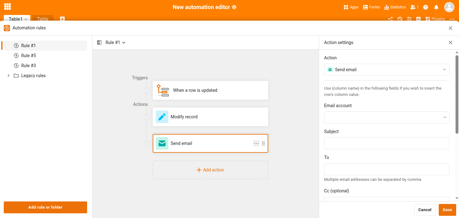

A sneak peek at the new automation rule editor:
There is a lot to look forward to!!
SeaTable 6.0 is on the home stretch!
The possibility of re-ordering the actions, as indicated by the grab handles, makes this update worthwhile on its own. :smiling_face_with_sunglasses:
Moving actions is not even a improvement. (This was also possible in 5.3.)
But you can change the sequence of the automation rules and you can organize them in folders. You can also duplicate actions.
Oh sorry, my mistake. I have confused it with the “button“ column action editor :wink:
This will also be supported in 6.0. :wink:
