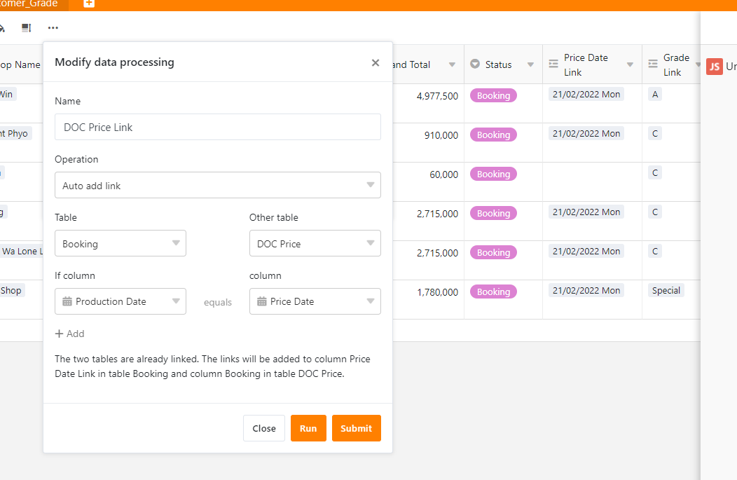

i have setup data processing operation as following.
when i trigger the “run” manually, it is working.
when i use the same setup for " automation rule" , it is not working.

I am using 2.7 DE self hosted version.

SeaTable DE does not support automations. But actually, you should not see the menu item.
maybe this is the reason automation is not working.
