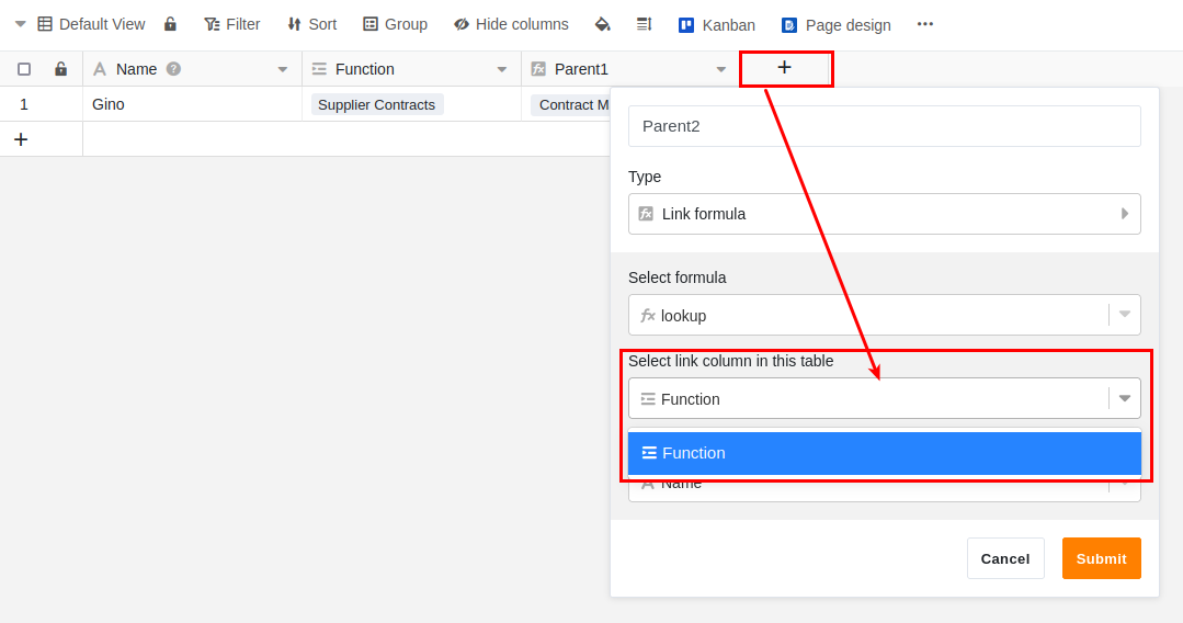

And here the table employee where i want to normalize the Business functions structure.
looking up the Parent1 is working out of the box, but the Parent2 is not possible because is not possible to select column parent1 as link column

Hi, yes I understood your case. This screenshot helped a lot: a picture says a thousand words.

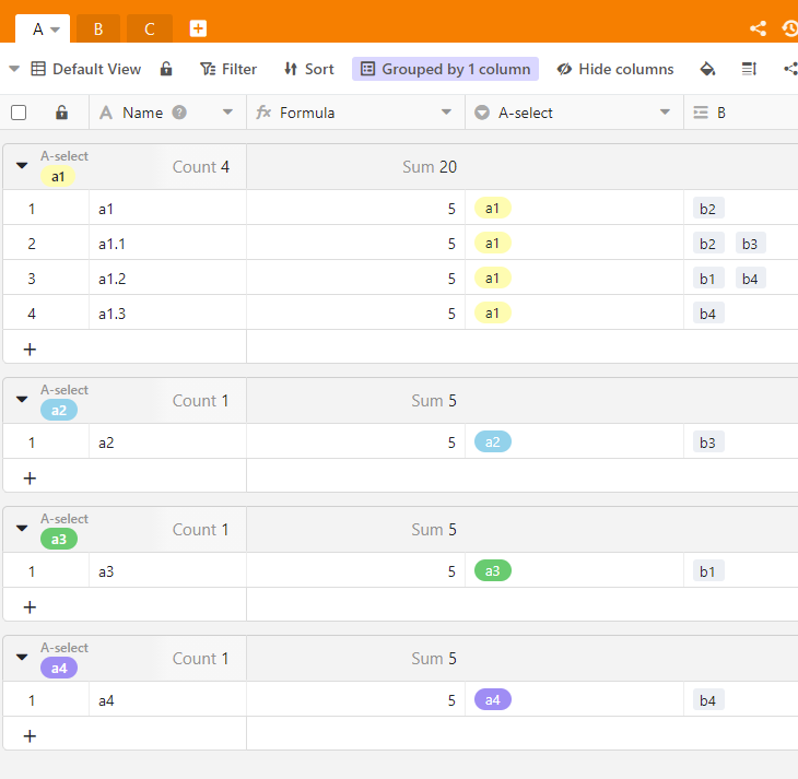

I present my example here:
I have a Table A, where “A-select” should be used in Table C:
Now, Table B is linked to Table A with a 1:n relationship:

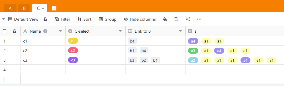

I have a Table C, which is linked to Table B, but not to Table A. In Table C, I would like to find the values from Table A who are linked to Table B:
And this is the result:

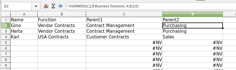

Because the hierarchy of the functions is already defined in the table “Business functions” and i want to select only the function assigned to the user, the parents are autodiscovered by lookup. see the excel example:
What I do here is only to assign the Function (via linked column). Parent1 is a lookup column, and Parent2 is also a lookup columns which is using as input the lookup column Parent1.

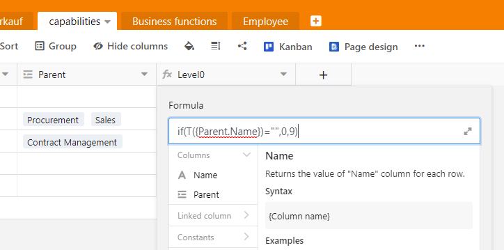

Now, to your question: You said in the table “capabilities”, where “level2” is, the value should be 2, but not 0.
I have taken a look into your table, and I’ve noticed two things:
  1. There is no “level2”, but only a “Level0” column.
  2. If the “Level0” column is what you mean, then you can only get 0 or 9 in this column, because you’ve written an if() function here.
In this formula you have written, you’ll get 0 if {Parent.Name} is empty, and get 9 if it’s not empty. Nevertheless you don’t really need to use the T() function here to transform the column name into text: merely if({Parent.Name}, 0, 9) can do the trick.
To learn how exactly the if() function works and how to use other formulas, refer to the Formelreferenz - SeaTable.io
