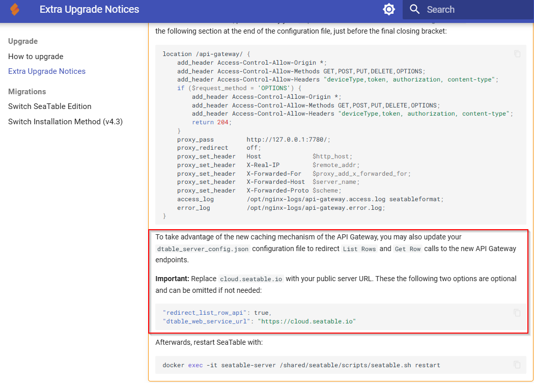

Server error → server log?!
[2024-05-21 18:23:57] [ERROR] axios.cjs[837] - get dtable related-users: 9031fe893ff0481eb11ae78e25963eb7 error: AxiosError: getaddrinfo ENOTFOUND data.cocolotravel.comapi
at Function.AxiosError.from (/opt/seatable/seatable-server-4.4.9/dtable-server/node_modules/axios/dist/node/axios.cjs:837:14)
at RedirectableRequest.handleRequestError (/opt/seatable/seatable-server-4.4.9/dtable-server/node_modules/axios/dist/node/axios.cjs:3083:25)
at RedirectableRequest.emit (node:events:525:35)
at ClientRequest.eventHandlers.<computed> (/opt/seatable/seatable-server-4.4.9/dtable-server/node_modules/follow-redirects/index.js:38:24)
at ClientRequest.emit (node:events:513:28)
at TLSSocket.socketErrorListener (node:_http_client:494:9)
at TLSSocket.emit (node:events:513:28)
at emitErrorNT (node:internal/streams/destroy:157:8)
at emitErrorCloseNT (node:internal/streams/destroy:122:3)
at processTicksAndRejections (node:internal/process/task_queues:83:21) {
hostname: 'data.cocolotravel.comapi',
syscall: 'getaddrinfo',
code: 'ENOTFOUND',
errno: -3008,

params: { dtable_uuid: '9031fe89-3ff0-481e-b11a-e78e25963eb7' },
method: 'get',
url: 'https://data.cocolotravel.comapi/v2.1/dtable-internal/get-related-users/',

@rdb I am noticing that the hostname has “api” appended to it. I wonder if this is supposed to be this way?
Thank you for your help.
Looks like you forgot a trailing slash. I guess it should be data.cocolotravel.com/api. Which API endpoint do you use? The api-gateway endpoint or the legacy endpoint?
@rdb thank you for your help.
That is what I thought to but the call looks good to me as you can see on the screenshot below.
I use the api-gateway endpoint. Could it be something wrong with the configuration ?
I tested the /related-users/ endpoint on https://api.seatable.io with SeaTable Cloud. The result: The expected response (see below).
Did you update to SeaTable 4.4? Have you paid attention to the upgrade notice for SeaTable 4.4?
@rdb I managed to make it work
Of course I respected all the steps in the Extra Upgrade Notices
Extra Upgrade Notices - SeaTable Admin Manual
BUT, somehow by simply omitting the last optional step the call worked
Maybe could it be that the
"dtable_web_service_url": "https://{public server URL}"
should be instead:
"dtable_web_service_url": "https://{public server URL}/"
With the trailing slash?
