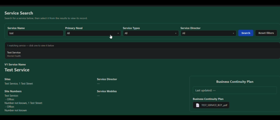

It happens on both the “Single Record” page type, and HTML
I’ve attached a short screen recording below of what happens on the HTML page.

Thanks for your patience. We tested both scenarios and found the following:
  • Single Record page: We could not reproduce the issue, and attachments should normally open without requiring access to the underlying base. One possible cause is that the App access session was overwritten by another App opened in the same browser session. This may also be caused by a previously opened App tab. Could you please refresh the affected App page and try opening the attachment again? If possible, please also close any other App tabs first.
  • Custom/AI-generated HTML page: We were able to reproduce the issue. Currently, attachments on this page type may require the user to have access to the underlying base. As a temporary workaround, the user would need to be added to the group containing the base.
