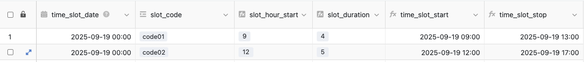

I have a table “timeslot_types”, with various properties of different kinds of timeslots.
In a different table “timeslots”, I (so far manually) add rows where I only specify the field “time_slot_date” (WITHOUT time component), and through links to the “timeslot_types” table and some link formulas, I can create fields “time_slot_start” and “time_slot_end” (WITH time components, so now viewable in a calendar).
(In the above, I should still include a “timeslot_id” field.)
I’d now like to be able to automate the generation of records in “timeslots”. E.g., for the period between [date_start] and [date_end], create 6 timeslots per day (2 of code01, 4 of code02). So for a period of 60 days, this should result in 60*6 = 360 records.
