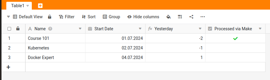

Base structure:
Besides the information of your course, you have two helper columns:
  • A formula to determine if the course was yesterday
  • A checkbox to determine if a course was already processed by Make.com
The formula of Yesterday is
dateDif(today(), {Start Date}, "D")
Make.com Action
Now, I would create a make.com action to check every day for entries where “Yesterday = -1”. Then run your actions and update the checkbox and set this to “checked” to avoid that an entry is processed twice in make.com
Easy, isn’t it?
