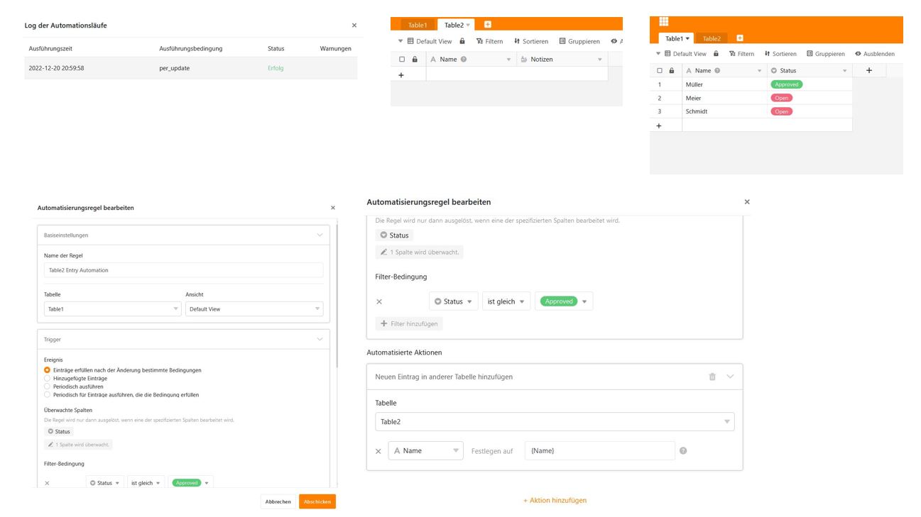

I have the probelm, that my automation rule was logged as “success”, but there was no change in the Table. Please see the pictures below:
Thanks in advance for yor help.
Marc
I confirm: The rule triggers, but the associated action is not executed.
This bug will be fixed in version 3.4.
Thanks for the feedback. When do you expect 3.4 to be released?
SeaTable 3.4 will be released in January 2023.
We fixed the issue in SeaTable 3.4.
Could you retest if the problem still persists on your side?
If the issue is a thing of the past, can you please mark as solved?
You are right. Problem fixed. Many thanks.
