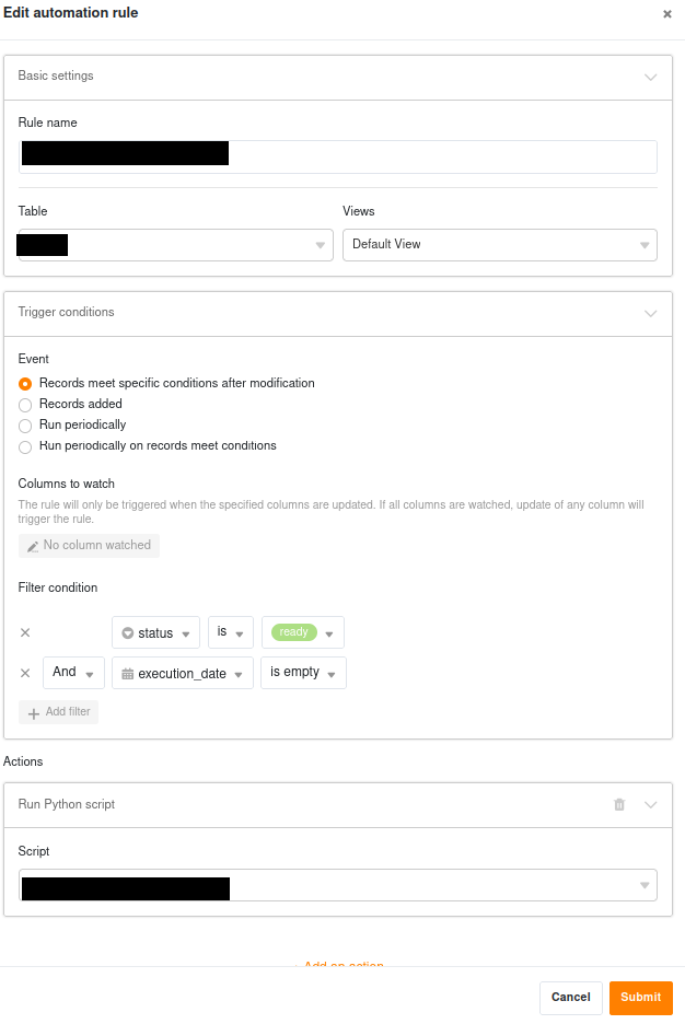

Currently I have two problems with the feature Automation Rule:
- We want to allow an event to be scheduled int the future optionally. Therefore I add 2 trigger rules with a script for a table. Two columns
statusandexecution_dateof this table are used for the conditions when the script is run. We use the context to get the current triggered row (context.current_row)
Two automation rules are:
Rule 1:
status=readyandexecution_date is empty+ eventRecords meet specific conditionals after modification. It is intended to run the script at any time if the conditions are fulfilled.
=> It works
Rule 2:
status=readyandexecution_date is today+ eventRun periodically on records meet conditionseveryday on e.g. 6:00. We can set theexecution_datein the future and schedule to run the script in some rows.
=> No python runner container was started in my case, I used the command watch n -1 docker ps -a and observed at the time on server and in the SeaTable UI (they are different) . When I clicked on Run now in the rule settings (see the above screenshot), the python runner container was started normally and the following error occurred in the container:
