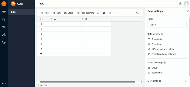

But I cannot reproduce the issue:
Bildschirmaufzeichnungvom2026-01-1622-38-54-ezgif.com-video-to-gif-converter
I tested on a test system of ours. But it is a regular SeaTable 6.0 instance. Nothing special about it.
Same in the app:
Bildschirmaufzeichnungvom2026-01-1623-07-55-ezgif.com-video-to-gif-converter
I agree that it is not optimal that the app does not refresh when an automation updates a cell. But: This is something we are working on.

Sorry: i probably should have been clearer:
Works in the Backend, but not in the App. Which led my colleague to expect both behaving the same way
As I said: I agree that it is not optimal that the app does not work like the base editor. We’ll change improve the app in the foreseeable future. For now, users (and developers) must accept that apps and bases behave differently.

As demonstrated in the videos in my previous posts, I cannot reproduce this issue.
