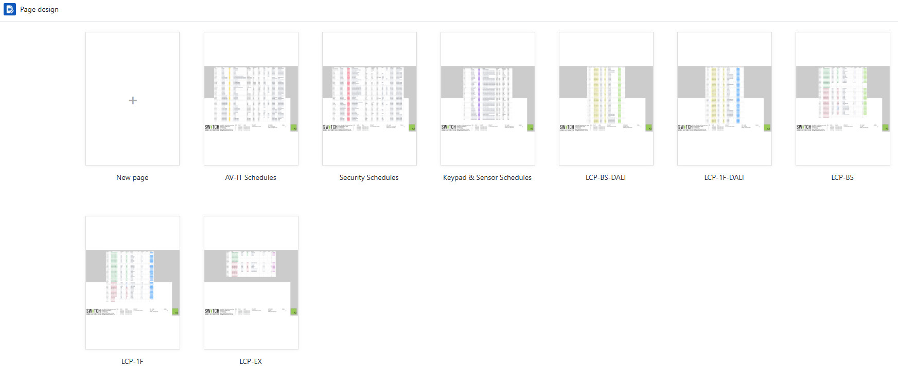

If there a way to print/export multiple PDF pages in page design? Instead of going inside each page and exporting one by one.

I already have several different pages.
The issue is I want to export them to pdf all together, not one by one.

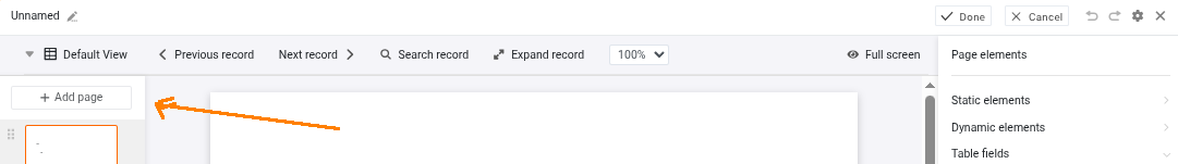

All pages of a multi-page template are printed to PDF. I don’t understand the issue.
Each page comes from different DBs of seatable, not the same one. So essentially separate pages, not multipage. I have to go inside each one to export to pdf
Does it make sense now?
Hi @Nicos, yes that make sense, however I don’t have any magic solution for you :pensive_face:
