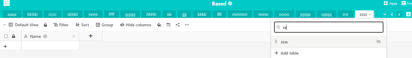

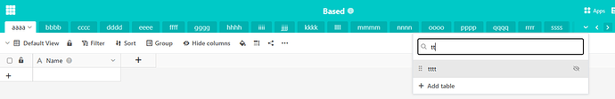

In a base with many many tables the search function was very helpful in the past. Since the update of SeaTable version 6.x this search doesn’t seem to work properly anymore. When trying to search for tables that are not displayed in the base header I can’t jump into the found table by clicking the search result.

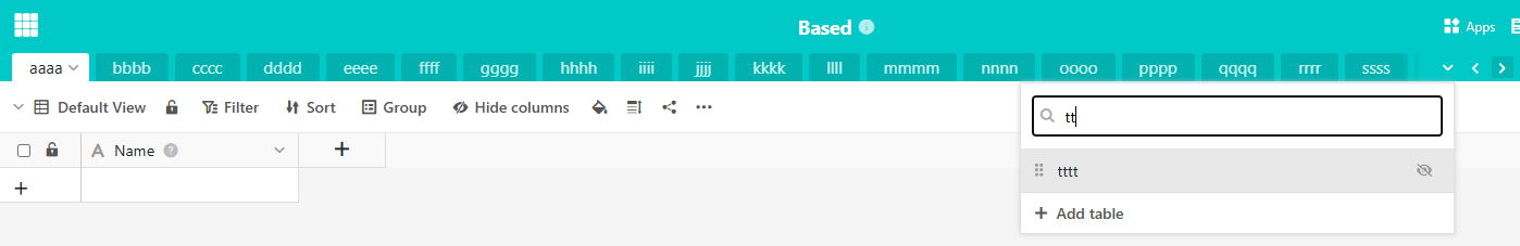

In this examplary picture I tried to jump into the non-displayed table “tttt” but it didn’t work:
But jumping into the last displayed table works:
Interestingly enough: The jump via search always works for the first and last table in the base, even if it is not displayed (in the example screenshots it would work properly to jump into the table “zzzz”).

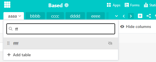

It depends entirely on the window size of the browser. In a narrower window I can’t jump into previously displayed tables:

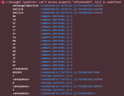

This is from my browser’s dev tools console (Firefox) when trying to access the first non-displayed table in my base via the search function:
Uncaught TypeError: can’t access property “offsetWidth”, t[i] is undefined
