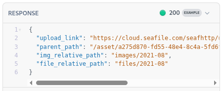

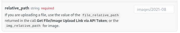

I guess you are referring to this:
The path that the upload link call returns includes the “files/” bit (see below).
im referring to the upload_bytes_file method from this documentation, where the relative file path hasnt been documented (yet). however, there is a bug in the implementation, if you look at my example code above, just adding a relative file path will upload the file to some inaccessible location (except via the url), only when adding “file/” to the file path argument yourself will you get the expected behavior. i dont know whether that bug exists outside of the python api.
