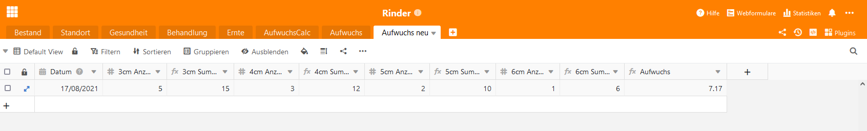

I record the measurements in columns because in the rows are following measures at other days.
Because i can only put 1 media into a post here the further formulas:
3cm Summe = {3cm Anzahl}*3
Aufwuchs = ({3cm Summe}+{4cm Summe}+{5cm Summe}+{6cm Summe})/({4cm Anzahl}+{5cm Anzahl}+{6cm Anzahl})
Here is the beginning of the table, more cm are still missing.
The subtotals will be hidden.
In {Anzahl} Columns i need the button click counter.

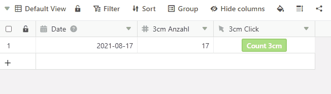

I see. So you can do this by writing a script. I have written the following example script:
const table = base.getActiveTable();
const row = base.context.currentRow;
base.modifyRow(table, row, {'3cm Anzahl':row['3cm Anzahl']+1});
And set the button to run this script. So when you click on this button, the number in the ‘3cm Anzahl’ will increse by 1:

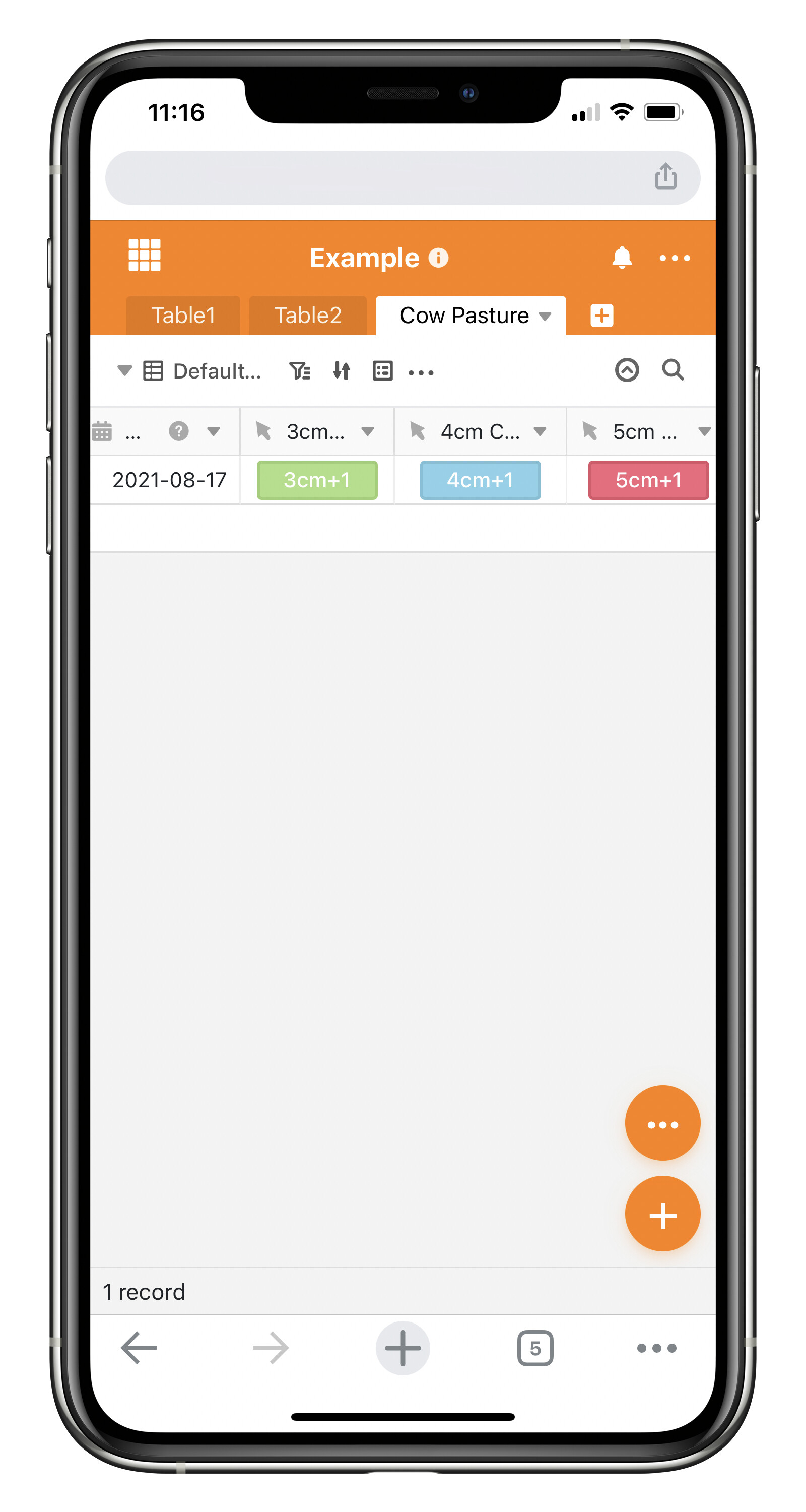

You can move the columns together so that the buttons are together, and you can rename the buttons so that you know what each button does.
Like this, for example:
