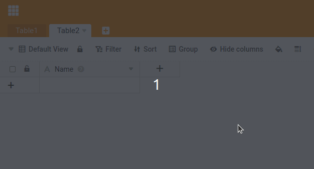

I can confirm that this works:
Peek 2024-07-05 15-36
Are you sure that the column names are completely identical as described here?

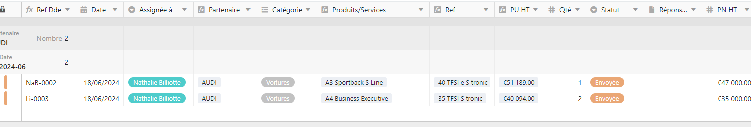

I checked my column fields and I corrected 2 fields, but not all fields are copied. In fact, only “Assignée à” and “Ref Dde” have been copied.
Here my source table

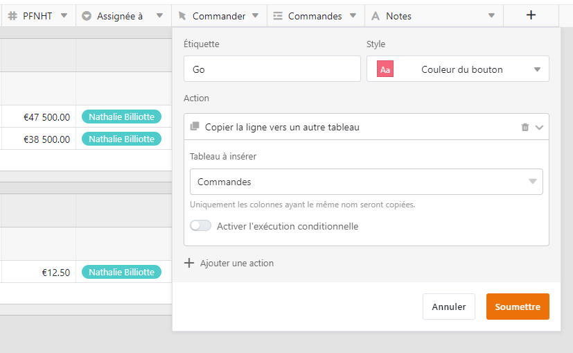

Here the other table, where I have some other fields
Is’it because some fields are relation field in both tables (same relation of course) ?
Should I have the same number of column in both tables ?
Thanks again
The cell values in link and link formula columns are computed by the system. They cannot be manually filled. As a consequence, you cannot copy values in columns of these types.
The content of link columns is NOT copied.
