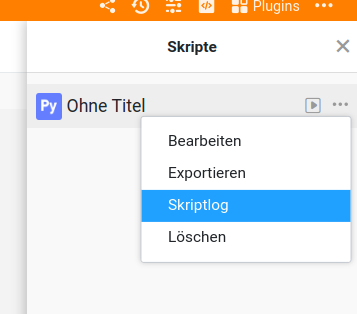

then you create a button-column and assign this script to the button. Every time you click on the button, the content of this row is sent to the webhook_url. You can get more details about the result of the call with the Skiptlog:
