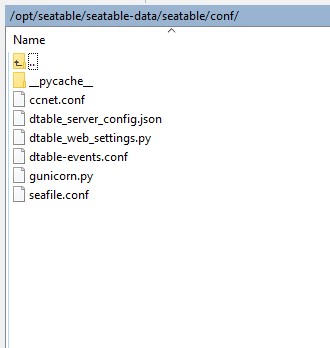

the problem is: there is no nginx.conf, no ssl configuration…
in /opt/seatable/seatable-data/seatable/conf.

The problem ist that no nginx is installed / working.
Screenshot 2021-04-13 141852
also “reload nginx” results in:
“/etc/nginx/sites-enabled/default” failed (2: No such file or directory) in /etc/nginx/nginx.conf:25

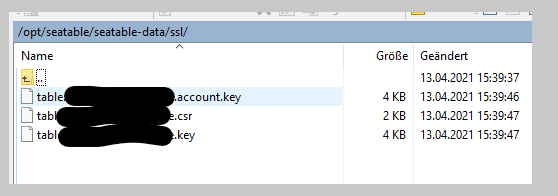

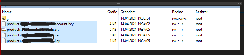

what is interesting for me is: once started the docker compose up. A certificate request is created:
but after a few second it is deleted (+ the nginx config file…)
