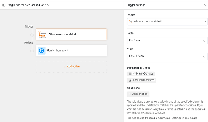

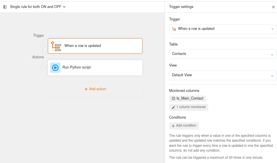

Now let’s assume I didn’t understand your use case, so I’ll answer your questions anyway:
  1. No, you can only run Python scripts via automations, not JS scripts
  2. Depending on what is the most easy to understand approach for you, you can either:
  • Create a single automation:
Your python script should then be able to deal to both Is_Main_Contact states (ON and OFF)

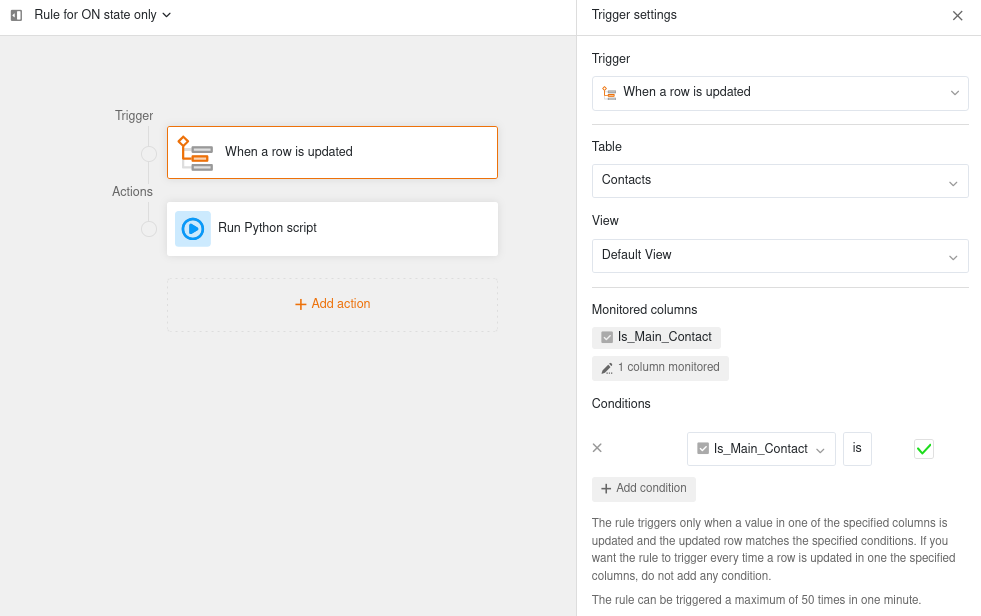

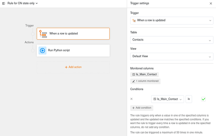

  • Create two separate automations: one to deal with Is_Main_Contact being changed to ON and the other one… well you get my point I think :sweat_smile:
As you can see, in this case, we added a Condition in the Trigger settings. Logically, if this is your preferred option, you’ll prefer having two separate Python scripts, one for each action (ON → linking the contact, OFF → removing the link)
