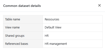

I do not know how we obtained this … but I have a circular reference between two tables using datasets.

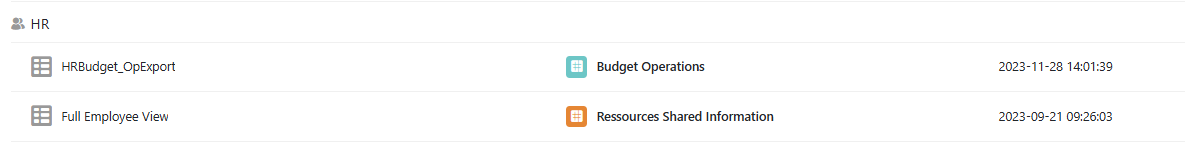

Everything happens in the same group called “HR”

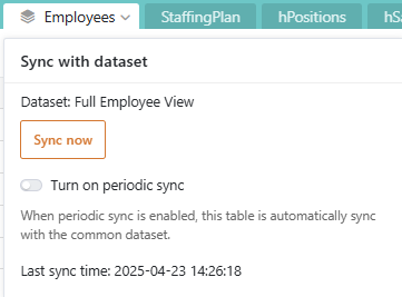

This table called “Employees” in database “HR management” seems to be based on a dataset called “Full Employee View”
Dataset “Full Employee View” is in a database called “Ressources Shared Information”.

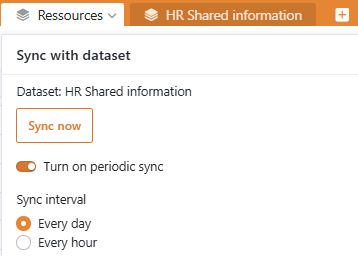

It is related to a table named “Ressources”

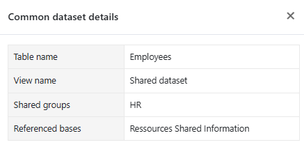

But this table is based on a dataset called “HR Shared information”
which happens to be from my first table

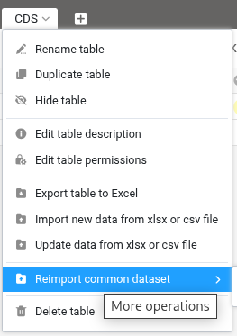

You can create CDS from any view of an imported CDS. In some circumstances, this may be sensible, for example if the 2nd CDS is based on a filtered view of the imported CDS.
Yet, you can also create circular references if you do not pay attention.
(Kudos to the person who did this. This is a first as far as I know.)
Correct. If you delete a CDS, all tables in which you imported the CDS will become regular tables.
