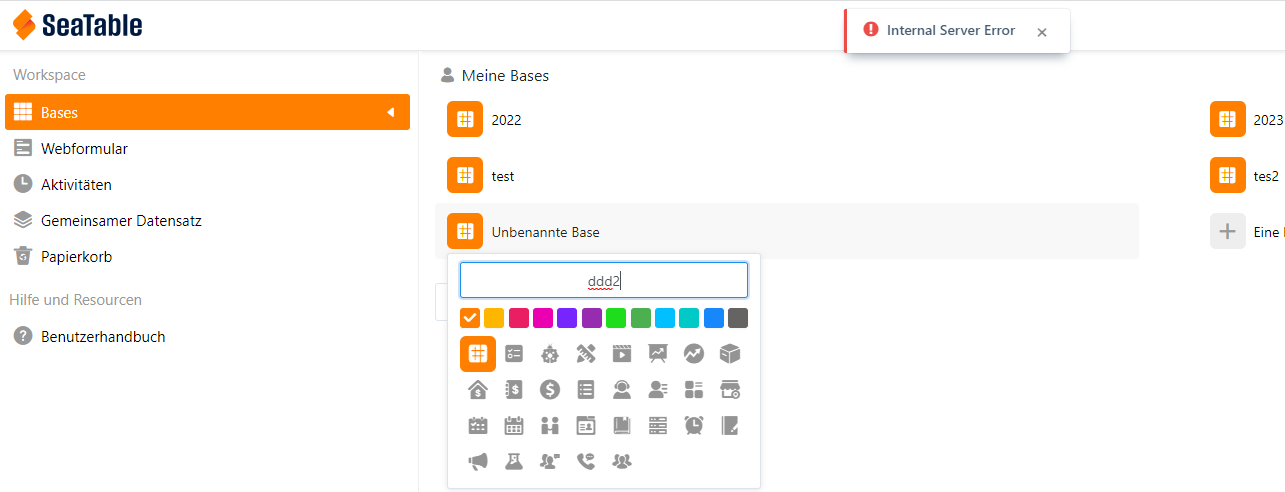

Hi all,
i’ve tried to install SeaTable EE several times as described here without success.
I’ve only set the domain inside the docker-compose.yml and left all other parameters untouched.
The instance starts without problems and i’m able to login.
While creating a “Base” the browser (Chrome) shows an “internal server error” and stucks.
After reloading the page, the “Base” exists but could not be opened. It results in a 502 Bad Gateway Error.
Any help would be appreciated.
Thanks
oetti

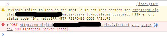

Have a look into the developer tools of your browser. There should show up some errors of not loading pages for example. What does it say?
This happens while creating a new “base”.
debug
So it’s a server error. You should have a look into the SeaTable log files.
