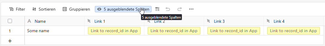

Is the column containing the rowid preset hidden? If yes, please unhide and try again.
Thanks, you gave me a lot of input to do some systematic testing today. I’ll get back to you once I have a solid result.
@rdb as always, you were right. The phenomenon occurs only in the App. And it has nothing to do with the column type.
However, the Column represented by the paceholder has to be visible in the App. Which I didn’t recognize because I added it after creating the initial App page, so the column got hidden by default.
An chance to change that behaviour? I’d rather not show a column with an internal ID to the user, but as a workaround, I’ll probabably will :wink:

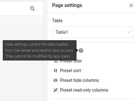

When preset hiding a column, the data from this column is not downloaded from the server:
At this point, there is no workaround. The column with the rowid must not be preset hidden. (But you can hide it using the user-facing “Hide column”.)
We may create a general variable for the rowid in formulas / buttons (something like {_id} or so). But there are no concrete plans at this point.
