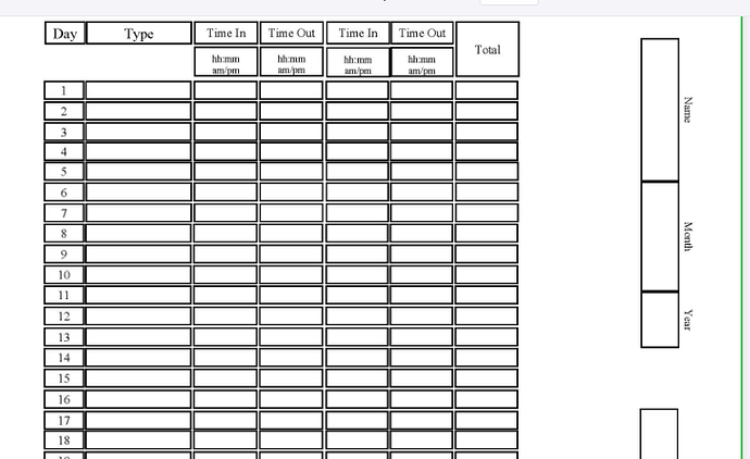

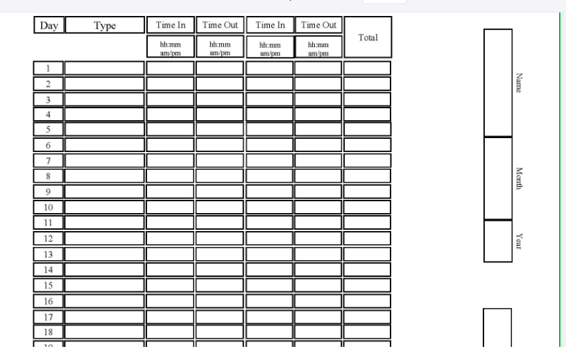

I also have to have a space for weekends. this is what end result will have to look like. On weekends we just leave them blank. I have inserted separate date column but when I delete the date and time on the time in column it delete the row?

I’m sorry, I really don’t understand what you mean here :thinking:…
Considering your template, just create 31 rows in your table (one per day) and leave the weekend days (rows) empty. Then, you can use the Page design plugin to get the output formatted as you want.
