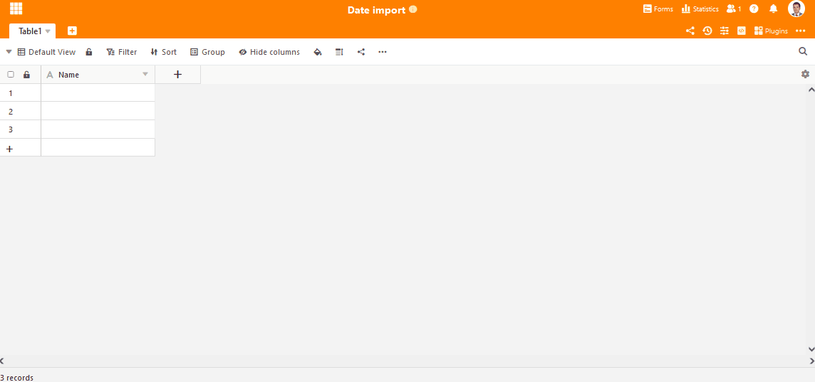

I cannot reproduce your problem. Importing dates works just fine as demonstrated in the video below.
If you haven’t formatted your dates in ISO format (YYYY-MM-DD), please do and try again.
