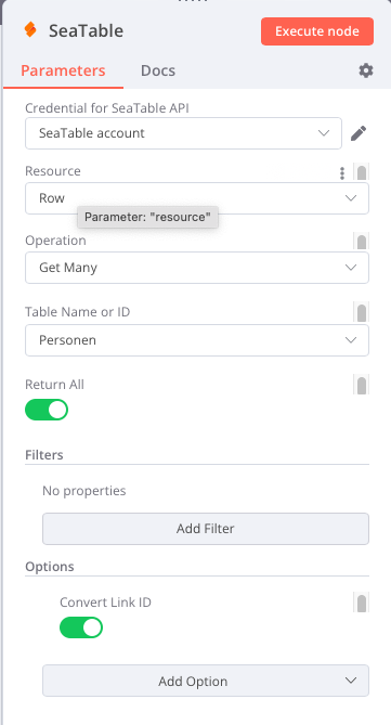

I am using the Seatable Node in N8N to get some tables automatically exported to a csv.
Inside the node of N8N (self hosted) it is possible to activate the Option “Convert Link ID”:
But the result is an completely empty column. When the option is deactivated I am getting the IDs.
As far as I see N8N is using the right command (Line 290):
Does anybody has an idea how to solve this and get the text instead of the ID?
Thanks!

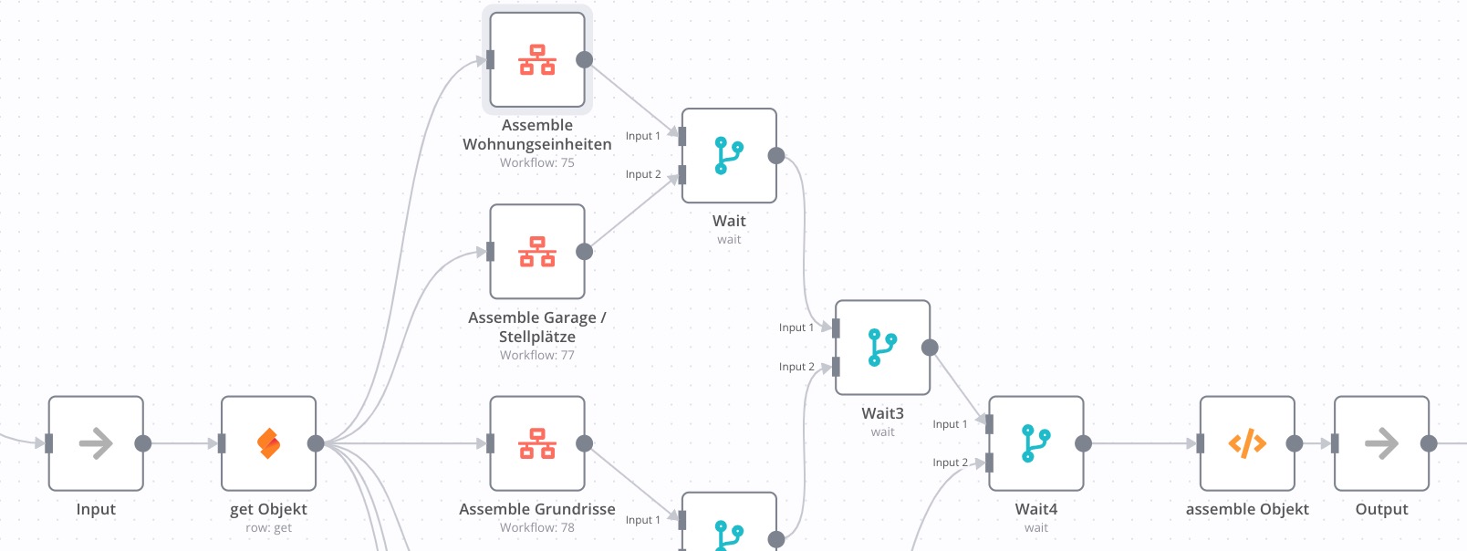

I’ve also recently had this issue. I have multiple columns with links and needed to solve it by having extra seatable nodes querying the ressources and merging them back together.
It was quite a painful and long process for something that I expected to be done by that option, actually.
Just a quick taste:
The subworkflows query each resource in turn, and in the end I assemble the data.
let objekt = $items("get Objekt")[0].json;
objekt["Wohnungseinheiten"] = $items("Assemble Wohnungseinheiten").map(item => item.json);
objekt["Garage / Stellplätze"] = $items("Assemble Garage / Stellplätze").map(item => item.json);
objekt["Grundrisse"] = $items("Assemble Grundrisse").map(item => item.json);
return objekt;
Maybe you can use a similar approach until this is fixed!
