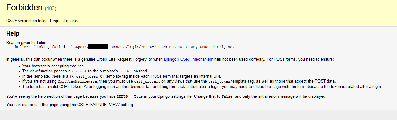

Hi! I’ve been wanting to give SeaTable a try but unfortunately I can’t get it to work.
I want to use SeaTable without the automatic LetsEncrypt certificate feature because I will be proxying it through my frontend Nginx instance which already has a certificate. After following the steps in the documentation (Redirecting...) and setting up my reverse proxy configuration (see below), I get a Django CSRF validation error.
- I’ve tried to replace
http://withhttps://indtable_web_settings.pyandccnet.conf(and restarting Seatable service or container, both ways) but it did not help. - I’ve tried adding
mydomainindtable_web_settings.pyunder a newCSRF_TRUSTED_ORIGINSoption, but it did not succeed either. The DjangoDEBUGoption also didn’t give me any substantial hints (just saying thatmydomainisn’t a trusted origin). - I’ve also tried to use it with
SEATABLE_SERVER_LETSENCRYPT=True(after removing all containers and bind mounted directories), but I hit the same issue as in https://forum2.seatable.io/t/seatable-1-8-developer-edition-docker-fresh-installation-broken/461 (where you get[...] open() "/etc/nginx/sites-enabled/default" failed [...]in the seatable logs) and I could not get it to work as per the answers (that is, making sure that it is set toTruewhen the containers are initially created).
Thanks for any help,
Niklas
