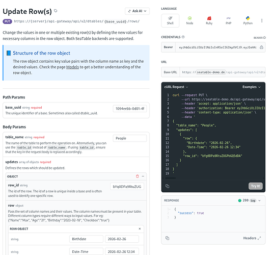

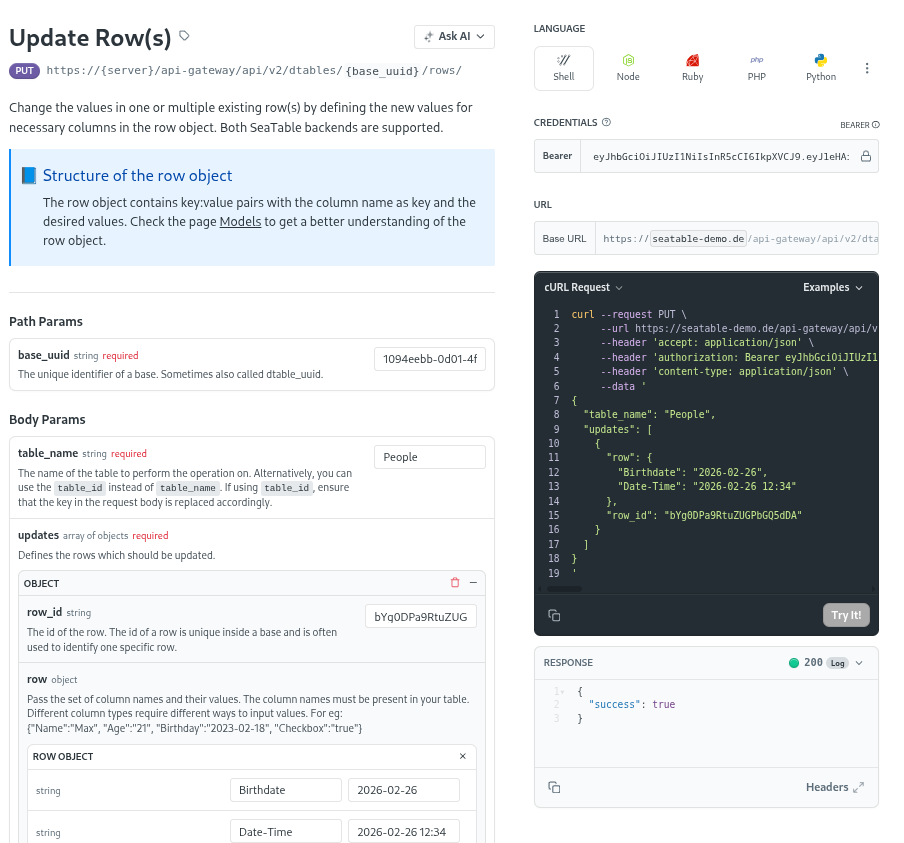

Worked like a charm:
Hint: I tested with a test system, but it is running the same version as SeaTable Cloud.
Hi rdb,
Thanks for checking. Folowing your test, I have found that I was sending:
“table_name”: “Messages”,
“row_id”: “XXXXXXm8VT8uhlmU9Lmjgpw”,
“row”: {
“assigned_at”: “2026-02-25 19:30”
And not the correct one:
“updates”: [
“row_id”: “CfbbPm8VT8uhlmU9Lmjgpw”,
“row”: {
Now, having updates as an array, as you said, works like a charm.
Your help is very appreaciated. Thanks a lot!:clap:
