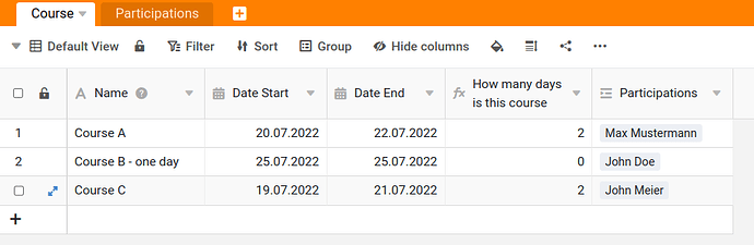

This is my first table “Course”.

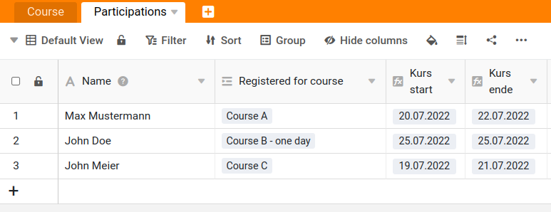

This is my second table “Participations”
Now I understand that you want to have a formular column. If the course starts and ends at the same day this columns should contain only this date. If the course goes longer than one day the column should say: dd.mm.yyyy bis dd.mm.yyyy, right?
It is definitely the case that as soon as you connect the two dates the column “thinks” this is a string and then the dates are shown with the wrong date format. SeaTable always stores date values in the format YYYY-MM-DD and afterwards change it in the desired format.
In this case SeaTable “thinks” the content of this formula is a string and therefore does not change the format of the dates from YYYY-MM-DD to dd.mm.YYYY.
By the way this is the formular I used to get these results:
if({Kurs start}<>{Kurs ende}, {Kurs start} & " bis " & {Kurs ende}, {Kurs start})
