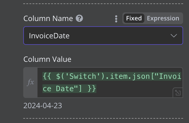

I’m using N8N to create a new row, everything works as expected except for the date.
I’m sending this Date in the Format YYYY-MM-DD
CleanShot_2024-04-30_at_19.21.54
but in seatable the date remains nil.
If I use a string column instead, the date is written as expected.
what am I doing wrong?
this is how the JSON looks like
    "Invoice Number": "6281894002",
    "Invoice Date": "2024-04-23",
    "Due Date": "2024-05-03"
same thing happens with the due date.
