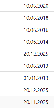

When using the Universal app, I noticed a problem when transferring date values from the app to the corresponding table.
After eliminating typing errors and systematically testing, I have found that entering date values from today to 01/01/2013 works correctly. If I enter an earlier date (starting with 31 December 2012), the date is no longer transferred correctly from the app to the table. The date that is entered in the table is transferred as ‘20.11.2025’ or “20.12.2025” (please refer to the screen shot below).

I can confirm the issue if (and only if) the format in your date column is set to “Germany, Russia,…” or “European”.
Thank´s! I can confirm that the issue is related to the format in the date column. Using e.g. ISO format solved the problem. So, there is a bug within Seatable but the work around to use an other date format is an usable option.
