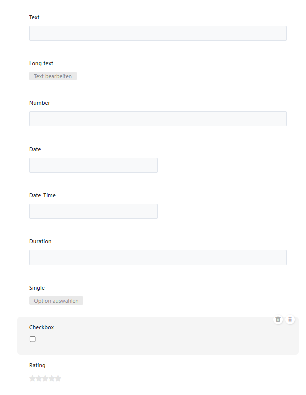

In the form editor, you can define default values for these column types:
With the exception of the collaborator column, it’s the same column types for which you can define default values in the base editor.
Having different default values in the base editor and the form editor may be counter-intuitive (for you), but it gives you a lot of flexibility when creating your use cases.
