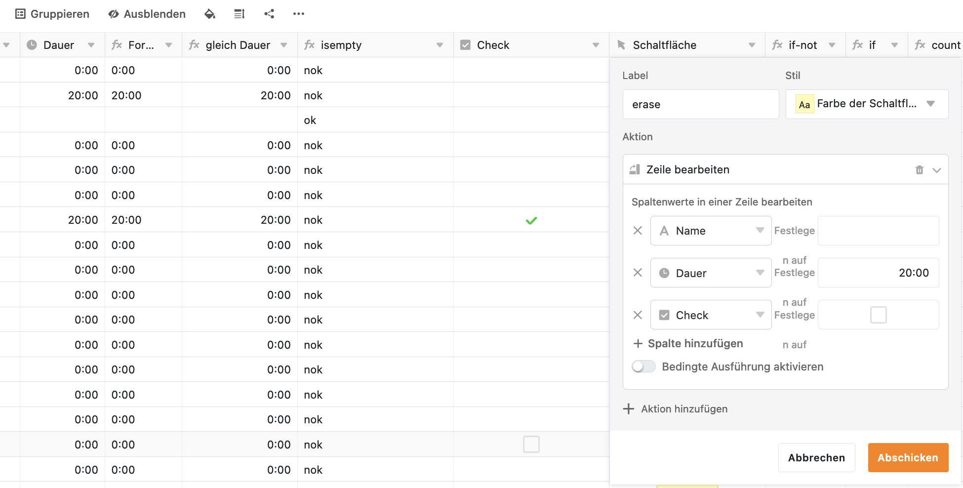

OMG!!! I was so sure that you need a script for something like that so I did not even look close enough.
Sorry for wasting your time ![]()
Thank you!!!
No problem. There is so much more to discover. Just click on every button you can find ![]()
