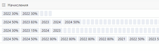

After some research i found, that problem only with this base. And complete error leads to some issues with links. Sorry, i haven’t provided full error log:
[error] PUT /api/v2/dtables/7c8efa4a-6baf-40ef-9114-74cd01569934/rows/: failed to get base 7c8efa4a-6baf-40ef-9114-74cd01569934 from dtablecache: dtablecache.BaseValue.Links: dtablecache.Link: dtablecache.Link.T
1Map: string: ReadString: expects " or n, but found {, error found in #10 byte of …|s0j3IgQ",{“_id”:“GKl|…, bigger context …|OwxrGUDoRTujUw9N9WJPvg”,“ZtHeoj56QQi0F2ls0j3IgQ”,{“_id”:“GKlevdRUQhWWx2maVZeszg”,“_mtime”:"2024-06-1|.
Before that we created links with api. And looks like after deleting some rows links still persisted…
Here is how it’s looks in the record. But i can’t delete it from interface
